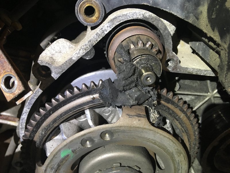

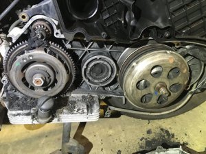

    Doing about 40 the other night, it stopped.
    Starter would not turn it over...so trailered it home. The pics will show you why it stopped, someone had stolen the drive belt and replaced it with a pile of rubber and string!

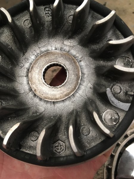

    Missing cooling fin on half the variator too.
    I also note that it appears to be an original Gilera outer half of the variator..so one half poling, the other half is Gilera..is this normal?

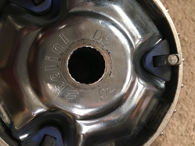

    Was not going to touch the variator or rollers, but since it was apart, thought it worth while. It has been fitted with a Polini D3 30 deg variation in the past and I see that there are noticeable wear marks on the ramps..and some flat spots on some of the rollers, that appear to be about 11 or 12 gram measuring on a set of digital scales.
    So to replace the variator...go with a new one the same ? or do I have a better option ?
    Before I order a new Polini do I have other better options..or is it pretty irrelevant?

    Rollers get flat over time due to them being thrown out against the fixed half pulley .
    yes its common to see the fixed half pully being stock and the variator being an upgrade, when you but a polini or a mallosi yopu only get the rear variator half, you use your stock front fixed half or you fork out and purchase a upgrade fixed half ( if polini/mallosi sell one for your scoot)
    the missing fin will cause an inbalance on the crank shaft over time, ie one area of the fixed half is lighter than the rest so it induces a wobble at high speed rotation.
    keep the variator just replace the fixed half pulley disc , replace the old rollers with new and grab a kevlar belt , jobs a goodun and should last you another 10,000km

    found the replacement outer pulley, not seen a different type. £25..bargin !
    There are wear patches on the old variator, looks like the chrome surface has been worn through in parts. Did not get picture of that
    Best I could do to check the weights of the rollers was to check on a set of digital scales that are not really designed for such small weight. A single 6 gram roller off of an Aerox weighs in at 4 gram and theses rollers i have weigh in at 10 gram..so they must be in the 12 gram area I guess, possibly a bit more
