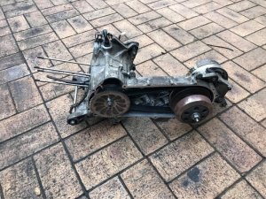

Hi guys I’m looking for a tool to lock the variator on my NSC50 so I can fit my Malossi kit. Has anyone found one that fits this bike you can recommend ? I’ve been searching the web and haven’t found any. Any recommendations appreciated !
chain type oil filter removal tool, 3/8 drive electric impact gun, you could try a universal locking tool, not tried one myself.
thought they would be easy to find, strange that no one makes one. though if your engine is like this one. it looks like you could use a piaggio one on one bolt or drill a hole in it to use 2, its ok on one bolt if you keep it level with your left hand while unscrewing the nut, or you could get a bit of steel welded on to it if its not long enough. if its not flush and matching use a few washers to space it out. so it would be small enough to keep in the tool kit as well.
