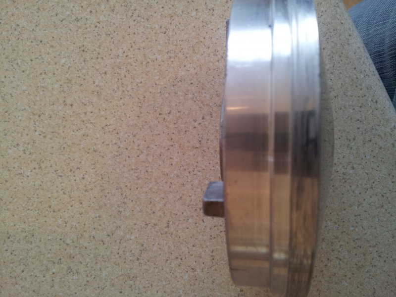

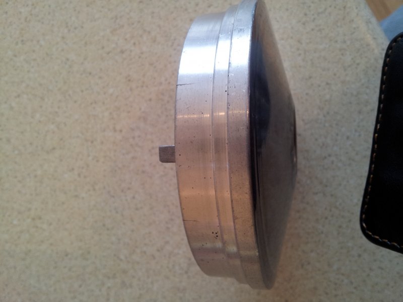

    hey dudes ive just got a second hand malossi variator on closer inspection after giving it a once over ive noticed a hand full of cracks/fractures round the outside edge ? has anyone every known this
    i cant find any info on malossi variators cracking cheers

    From my past experience a variator would only crack if its been put under such high pressure for a long period of time, also if the variator bolt came off then that would crack it. personaly i wouldnt use it. For the price they are i would always buy them brand new

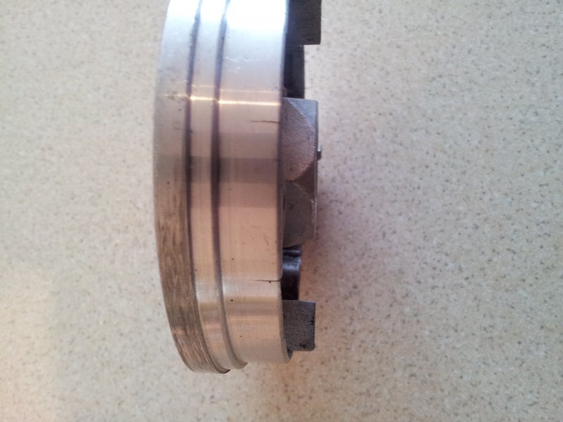

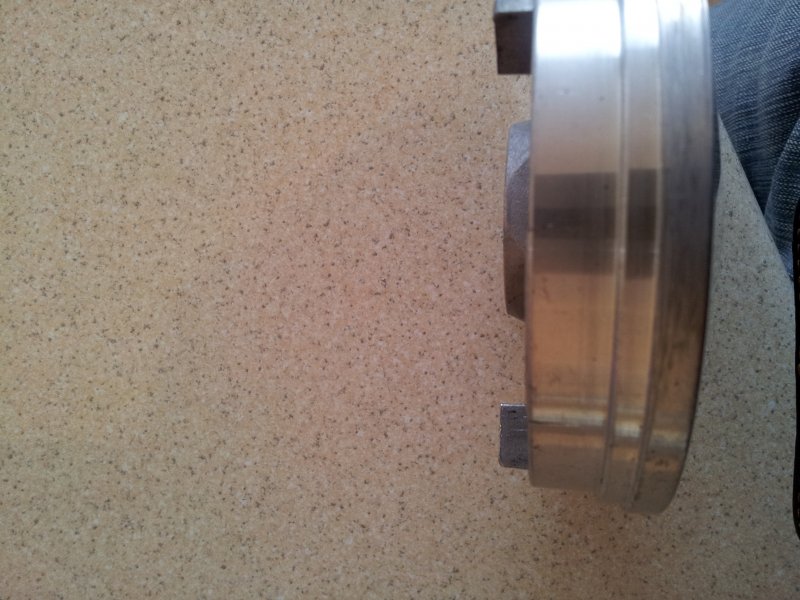

    its on the outer edge so if you get a variator and put it face down so your looking at the back plate the outer edge of the variator is what is cracked. so when on a engine its the edge closest to the engine

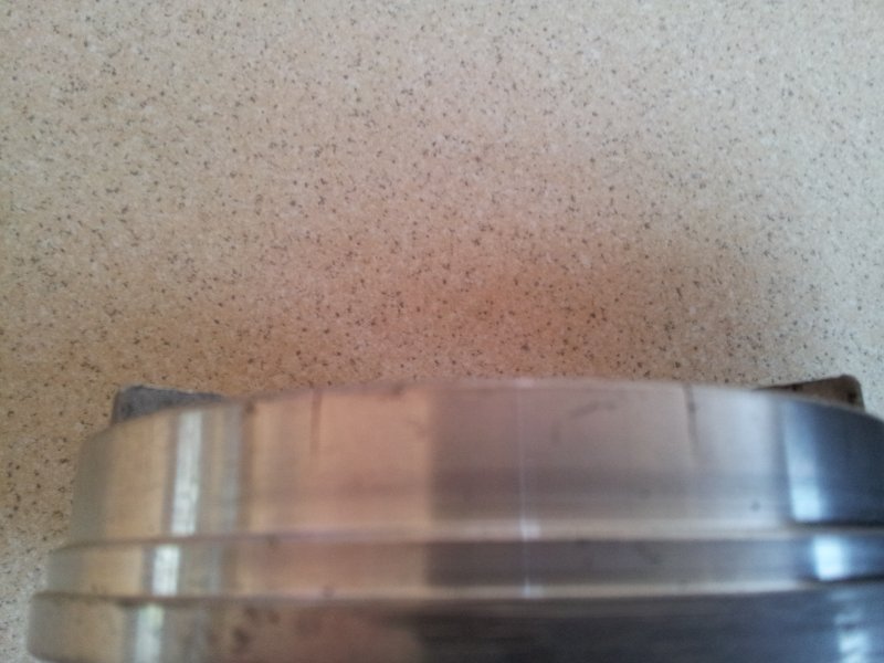

    whats peaple's thoughts ?

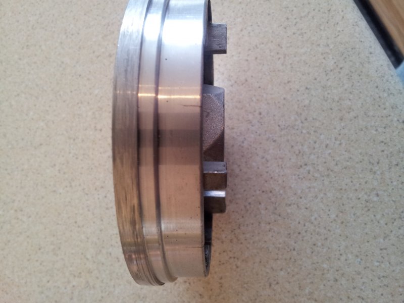

    i'd be tempted to email Malossi with the photos and see what they say. Might even replace it FOC. Theres no way that should happen. They look like stress fractures from the pics and its not as if that section of the part takes any abuse in any way

    Yup stress fractures, fault in manufacturing, I wouldn't trust it, last thing you want is the variator throwing a hissy fit and fill the housing up with bits of alloy, like has been said, contact malossi, email photos( sort out focusing, the clearer the better) these parts are for racing, built to take high pressure. :D

    only problem with that is you cant get a good clear picture because of how shiny it is i tried everything i could think of and these are the best pics i could get

    an my variator was complete but worn god alone knoes how long in use,just looking
    at that pic you can tell its damaged!,i'd get rid and replace no question!
