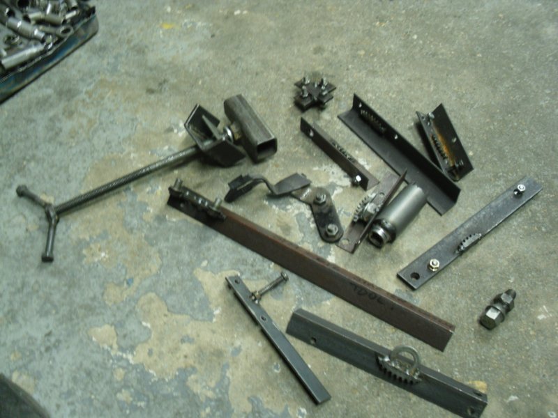

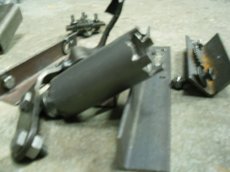

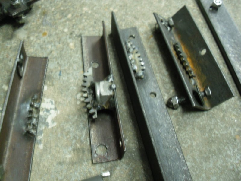

    Here's a few of my home made holding/ undoing tools, they might not look pretty but they work pretty damn good!

  11. lee mason
    lee mason Active Member
    680
    suzuki rg125 gamma
    didnt think of making a tool for it think ill drag the welder out soon and see what i can come up with
