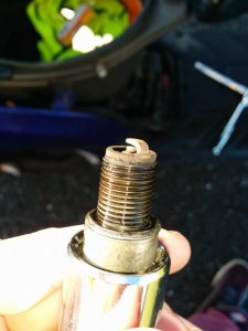

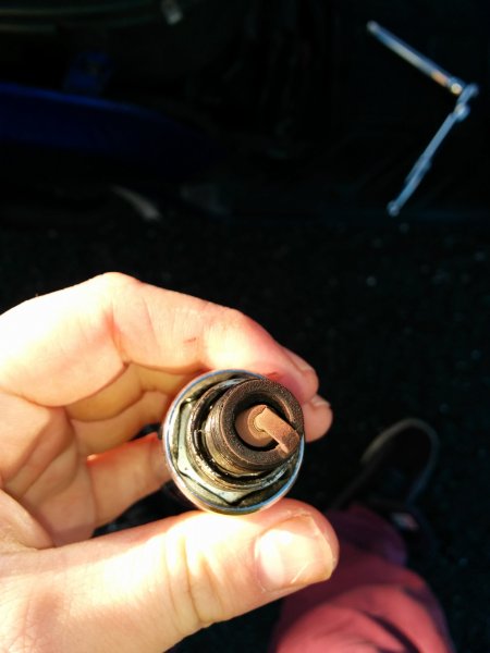

    Evening as the title suggests my typhoon xr 125 is running way to lean and its eating fuel I'm getting like 52 to 56 miles out of a tank if I'm lucky and there are no leaks on it. Took my spark plug out today and it's brown at the end any one have any ideas the only mod is a technigas pipe not my choice it was already on it wondered if the jetting could be out but unsure.

    On a std typhoon with Mikuni carb, it has a 86 main jet, that plug look's about right for a typhoon, it could use a 88 with the exhaust. Have you got the front tank fitted?
