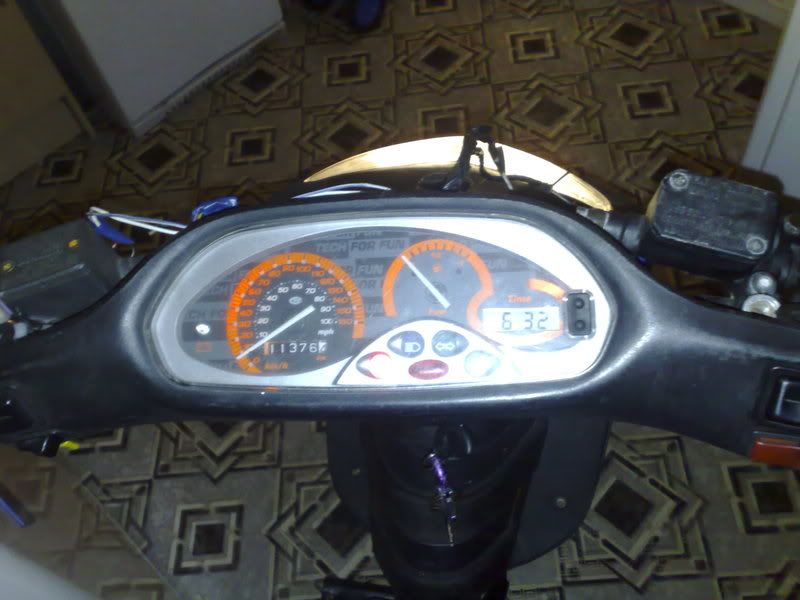

    well on my ice my petrol gadge and petrol light doesnt work. im using typhoon 125 clock because they was easier to fit the loom.
    the wires are connected up and the float is working. (tried two different ice tanks).
    also my indys dont work but used to when i had a switch gear. (connected up all the right colours so they should work).
    here a pik of the clock. for no reason :D
    thanks
