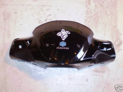

    was just wondering if a nrg clock panel fits onto typhoon clocks or you need to run nrg clocks for it to fit?
    is this suitable?
  2. MiNoR cOnFuSiOn
    nrg and runner are the same inner pannel (so are interchangable) the typhoon has a diff clock pannel and clock shape so you can only use these on a typh. some (like the storm) have an nrg front pannel and clocks (wiht the nrg loom respectivly) AND you can adapt the typh loom to run ether nrg/runner clocks. ether 125 or 50.
    but no, if you have a typh, with typh clocks then it wont fit
