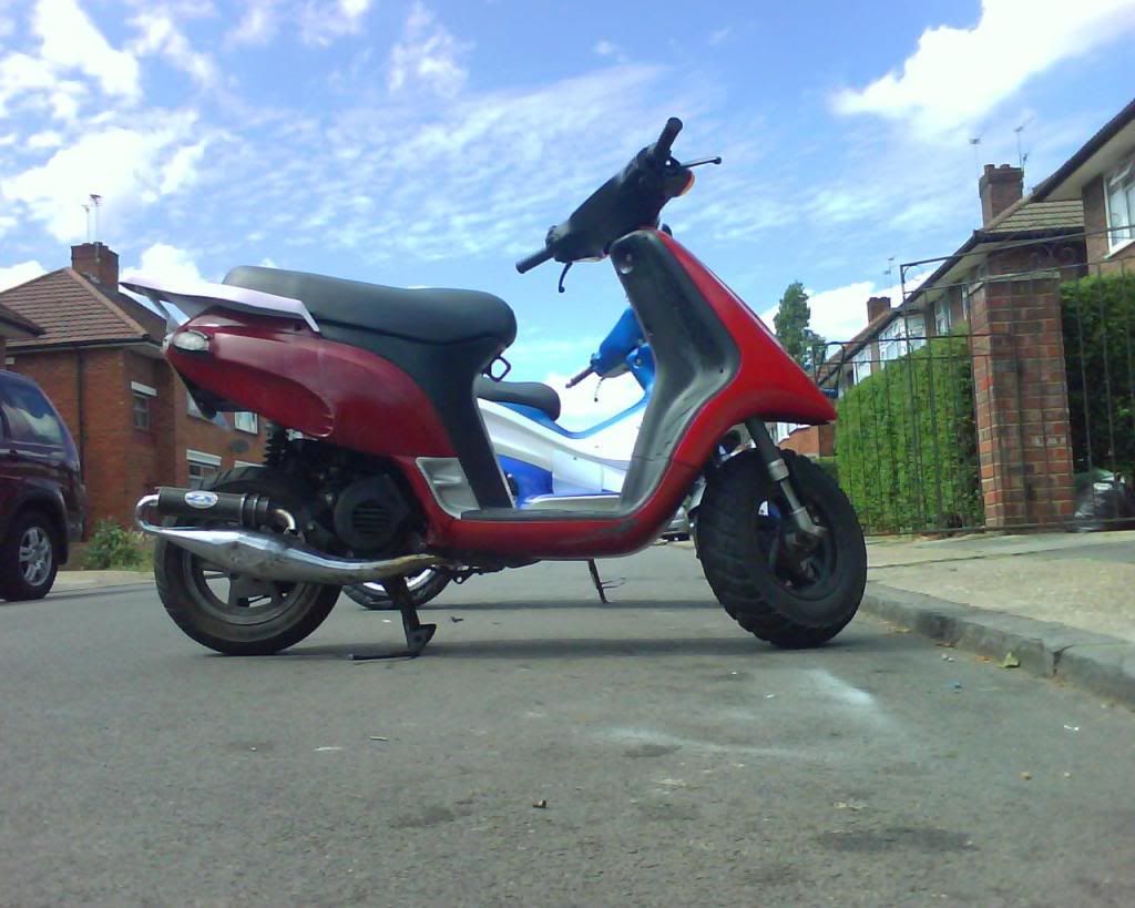

    im planning on putting a standard 80cc typhoon engine in my 03 stalker, i was wondering if my 50 stator would fit on it because it has to 6 pin clip thing and the 80 engine has the old wiring and would a 50 exhaust fit on it aswel? also i was wondering if the 80 engine would have higher gearing in the reduction over a 50?

    not sure on the gearing but im sure the stator/flywheel is the same.. you DO however need to grind a peice of the case away to acomidate the wiring from the stator as they travel in a different path, you will see the difference if you have the two side by side.. will also be able to mark it wihtout as the stator fouls slightly.. soon see what i mean ;)

    yeah you can put a 50 exhaust on an 80 engine.. i had a zx on my typh 80 conversion :mrgreen:
    and i the 80s have more top speed than a 50 so i think the gearing would be different

    ive got the engine in and started now just one more problem
    my back wheel doesnt fit lol from looking at it the 80 engine needs a skinnier wheel or just a dirrefent fitment on it, any1 have or know where i can get a wheel to fit a '96 typhoon 80 engine?

    nah, its an OLD shape engine, i have one myself.. 100mm drum, terro has a new wheel somwhere im sure he would part wiht for some dogh.. could pm him and ask? it is new tho so no tyre and pristine condition.
    only other way your gonan get one is off another typh.. OR a verry old sfera/old old old zip
