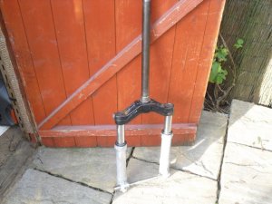

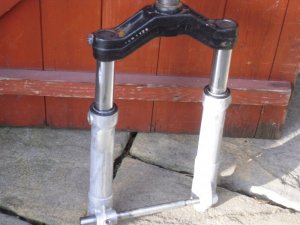

These are the fork's, benelli 491 fork's made to fit typhoon/runner 50 wheel. 32mm stantions like f32's, new seals/fork oil, have cut the mudguard lugs off that the benelli used, stantions have very light pitting but nothing to bad. It has an original malossi fork stem, come complete with wheel, caliper. Malossi mudguard brackets included and a spare set of malossi seals. These will fit straight in a typhoon using 10" typhoon wheel, make up a caliper extension bracket to use a 12 or 13" wheel. Just need spraying silver/red and they will look like genuine f32's.
there very nice i will let greek take first dibs on these as he was here first but if he doesnt want them let me no what price you are looking at for them.
I'd like £140 ovno posted, these type of fork's don't suffer wearing bushes out like typhoon fork's do! As i've said, these will fit straight in, all spacers, speedo drive all there.
