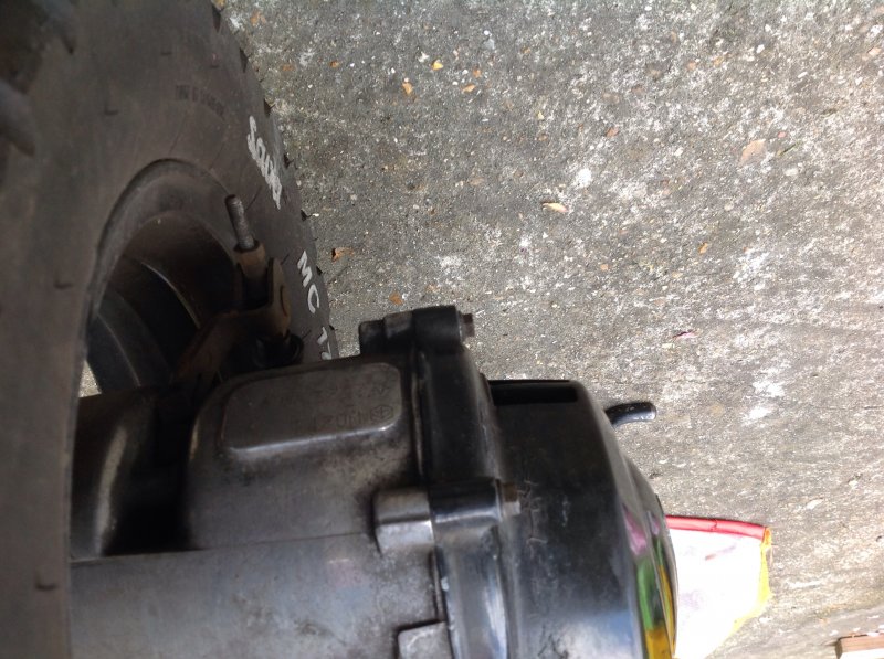

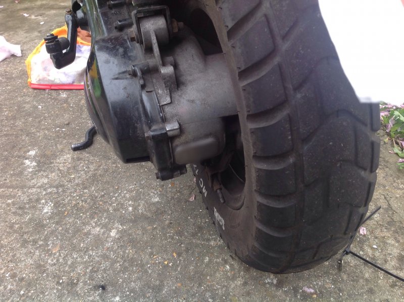

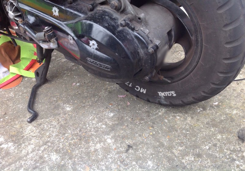

    Marsh you sure that a new crank will fit in my typh, im also reading all over this site that pre 2000 engines have a rubbish crank and no aftermarket cranks will fit, its an s reg...also read something minor said about it being fine if it has the new engine number place rather than the old one heres a couple pics let me know please.
  7. MARSH
    MARSH Whooooo!
    3,266
    Piaggio Typhoon
    I have that engine in one of my Typhoon's, mine is an x reg 2000 but that engine, non rolling nut small drum. I'm 99.9% sure it will be ok. If your in any dought you could buy a later rolling nut engine and I'll take that engine off your hands, It's not a problem to have them machined if there to small!
