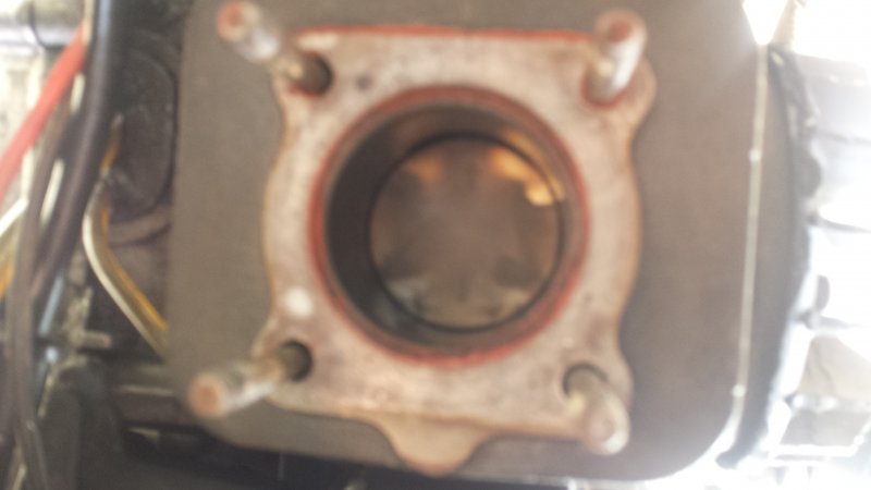

    Hi i got my ped on the road and i went out for first ride and it keep cutting out and plug was dry and brown ish and can it be oil

    Brown/dark brown is cool, greyish is what you want to avoid. I had something like that when the float in my carb wasn't at the right level. If its only at full/near full throttle it could be something to look at

    I found out its tge cooling fan cover is missing so its heat sizeing has anyone got one close to nottingham or derby

    looks like it could have run a little lean, might be worth putting a slightly bigger main jet in, like around 2 points up
