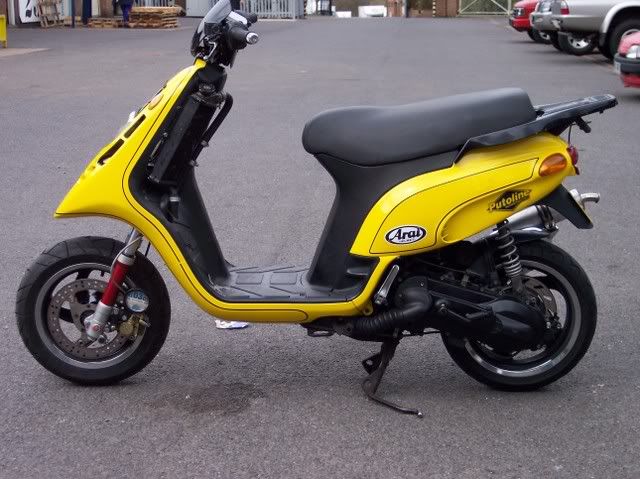

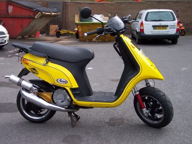

    Piaggio Typhoon
    Fitting a runner engine to a typhoon is no problem at all! as long as the typhoon started life as a 125, the runner and typhoon engine cases are the same, as are the engine mount. The typhoon pictured looks like a 50cc as the engine is mounted further back than usual, if it is it will ride horrible due to vibration from the engine. I'm all for l/c engines as they are faster as std than the a/c. This was my old typhoon with a 26hp PSN motor, i sold it to a good bloke about 18 months ago.
