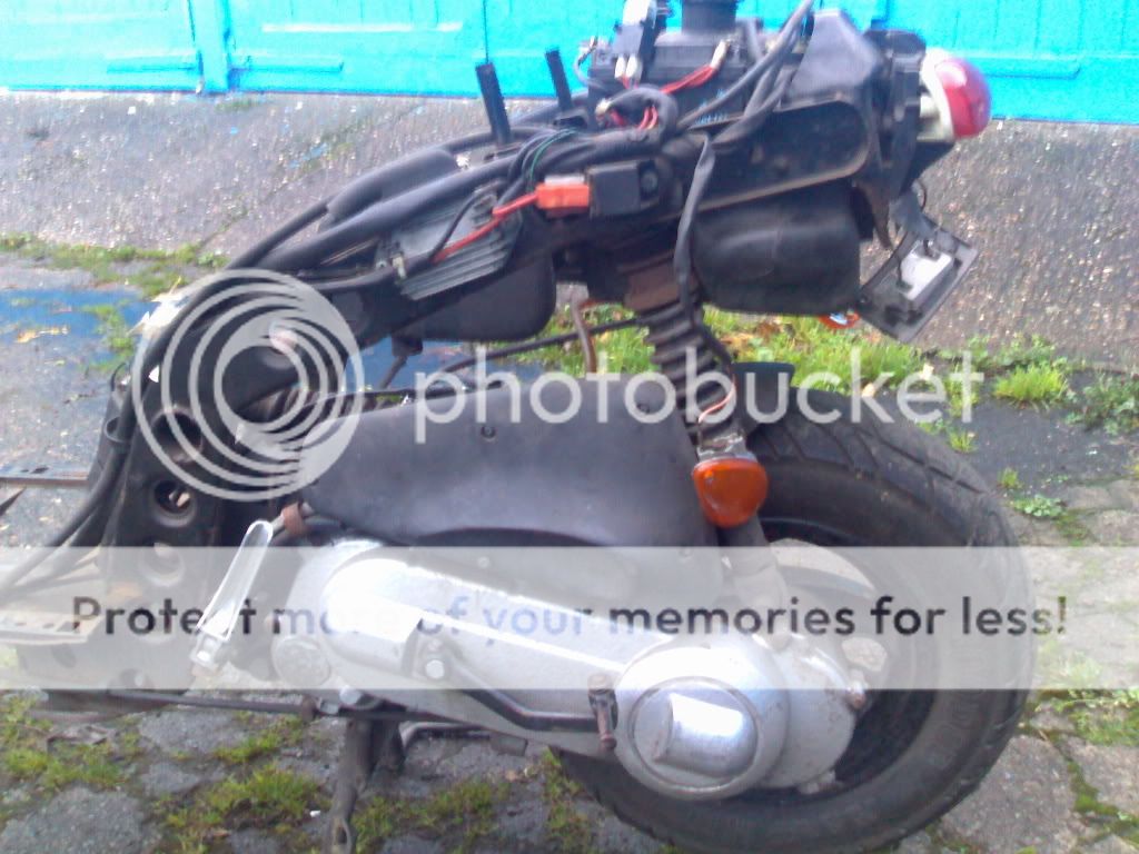

    Does anyone have a pre 1998 typh with log book just to have a look at the engine number to see what it starts with TEC2M etc etc
  5. MiNoR cOnFuSiOn
    or take a pic.. and ill TELL you :confused::confused:

  7. MiNoR cOnFuSiOn
    ye old shape engine.... same as mine. all the same EXCEPT the gears are diff, the rear pulleys are also diofferent, the belts are SLIGHTLY shorter. other than this any part for a 50cc typhoon will fit fine. can fit a new shape engine but theres no real need unless your going all out tunning wise. the small rear pulley meses wiht the usual roller weights (had me scratchin my head befor i actually messured things that i thought would be the same... never assume)
