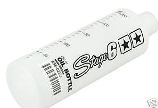

    Hey guys, my typh 172 doesnt have an oil tank so i have to premix when filling up.. How much oil to 1 litre do i put in?
    I think i have the right idea but not too sure.. is it for every liter of petrol i put in do i put in oil upto the 50 marking each time? :/ need help lol..

    Nope. Say you were mixing 33:1 (I would in your case), you add say 5l of petrol with oil up to the 5 mark on the bottle under the 33:1 column.

    Sweeet thanks! :D
