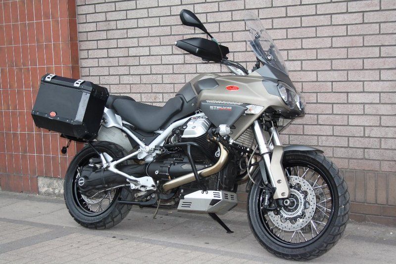

    I just picked up another Italian two-wheeled toy that's taking up most of my spare time now . . .

    OMG...I know that drive shaft and those twin cylinders. What a beauty. Is this the Guzzi? Did they license from BMW?
