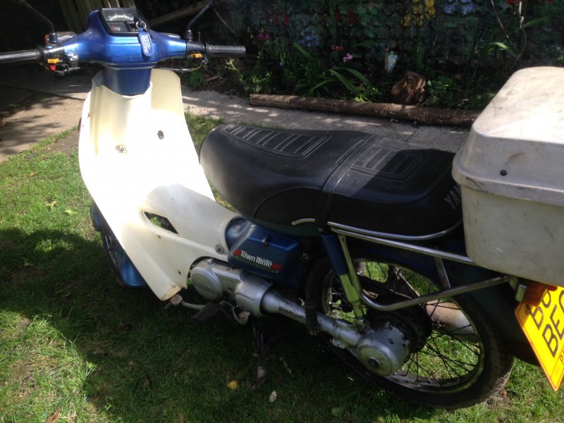

    what are the con sequences of over filling a engine with oil , about a 026.JPG inch a bove the mark on dip stick

    I don't know if I made the fact clear its not that bike in the picture its my van bit of a red herring putting a bike photo up but its not very interesting a photo of a berlingo
