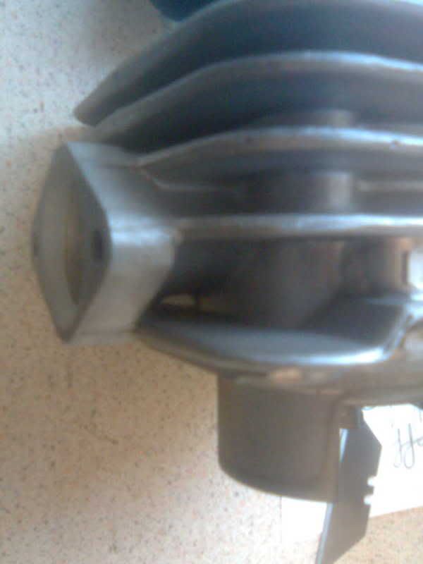

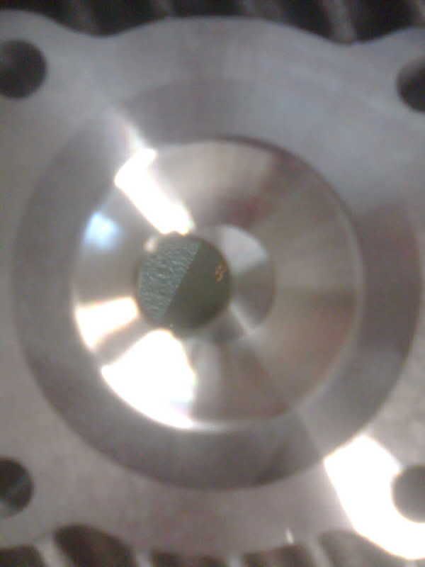

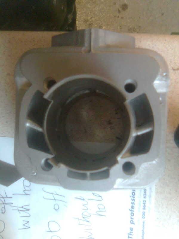

    the barrel came in good time from scooter attack (as always) but there were a few problems with the kit, some expected some not. the main one was the location of the plug hole in the head (drilled at a strange angle and in the wrong place) you can see it in the pics on scooter centre (should have looked) but not happy and emaild them to see what can be done.

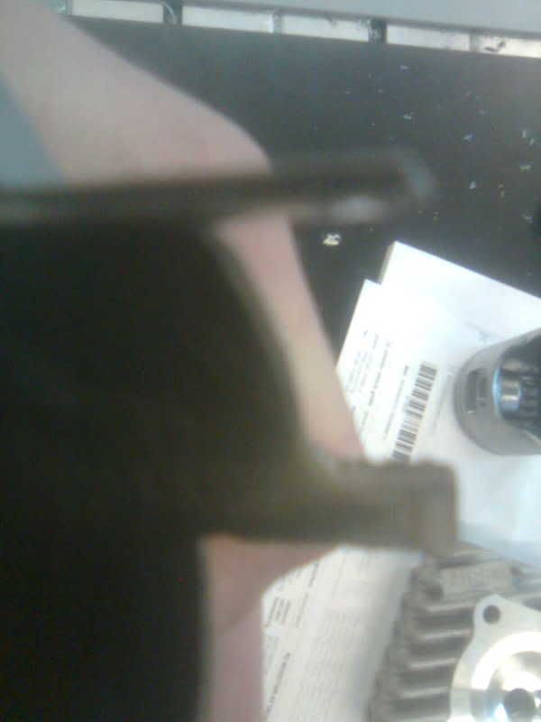

    there were a few rough bits on the skirt, obvious casting imperfections that wernt really monitord correctly, so much so that it prevented the piston entering the cylinder smoothly wich is quite worrying really.

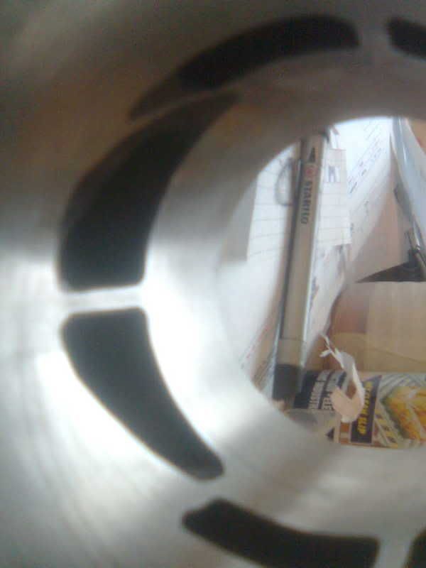

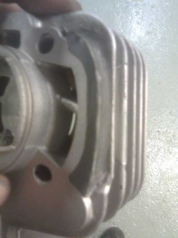

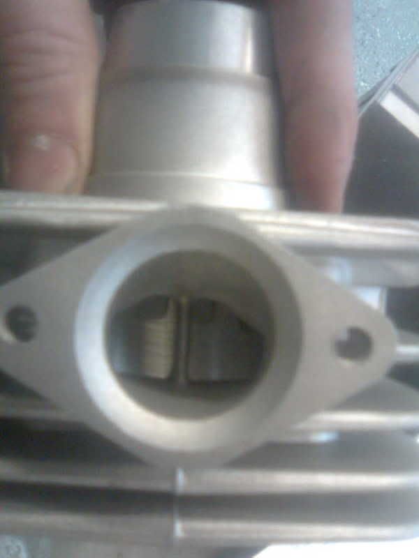

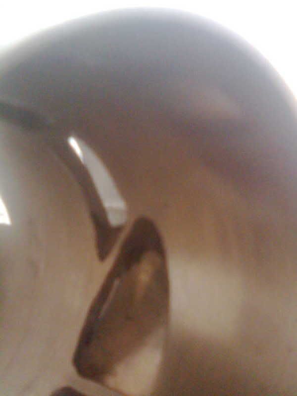

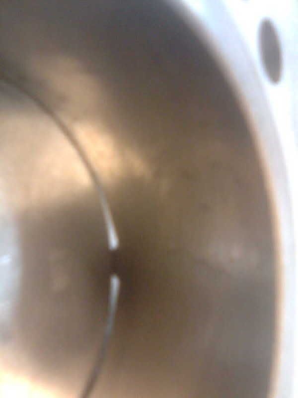

    the port layout is nice altho they were ALOT less tidy than i was expecting (and i do mean rough shaped ports out the box) the hights wernt TOO bad altho the exhaust port is just a complete mess, not going on anything like that. the entire exhaust tract is misshapen and there isnt much meat in there to open it out altho this can be rectified easily. anyway heres a few pics of the general condition of the kit out the box
    as you can see its verry promising but needs alot of work to get it as it should be.

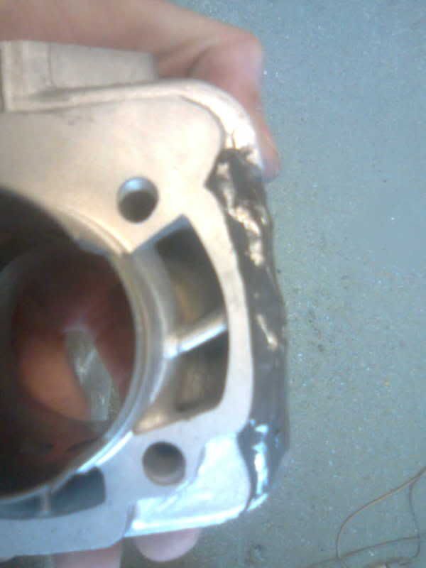

    now the fun starts and i started to mark up/infill for the work, the transfer feeds are verry big as std (altho the gasget isnt?!?!?!) so suits a flow'd case. altho mines prity thin so i thought id infill to maximise the seal area (less prone to air leaks obv) also marked out how i want the ports altho not quite as close... have a paper template i drew up but really cant be arsed uploading more pics.. anyway, what was done yesterday about 3 mins after it came out the box

    thats weird about the plug position youd think they would inspect em before packing any news from sa if there going to do anything about it

    my 70 kit had the spark thing drilled like that... wasnt a airsal though it seems to work fine though but still its sloppy we pay money for it least they could do is machine it right...
    and yeh in the picutre on scooter-attack its off centre to i should have looked also :>

    it is a bit of a pisstake.. ima use a random malossi head with it i think (might take it down a little tho) will compair the pistons an volume's. should be a lil ripper tho thas for sure, that map (if the transfer wasent so close obv) with the right hights/pipe will see easily what an evo can. just lots of work in the exhaust port, and i do mean alot :confused:

    nice 1. what did you use to fill it? chemical metal and?? or just that? and how did u manage to get it to be perfectly level as the base?
  10. kyle1b1
    probs a file am guessing
  11. nibbles
    nibbles Active Member
    2,169
    it shows u in the pics lol he put a bulge of it on lol like stickin over how high it needed to be the put like 2 mm plastic over it n g clamped it then removed wen it dried im guesin from pic. cmon people lol haha any nice m8 am watchin this space
  12. MiNoR cOnFuSiOn
    ye thas the idea nibs, altho i removed the first lot and backfilled it with the plastic in place as its prity easy to get to.. its acrylic with a film over it so you can peal it off (nothing will bond to this film prittymuch) wich was handy. so much on atm i dont know when ima get more done but ill probably have a play in my lunch break or somthing (if im not chatting shit on facebook to whatever bit of bored minge is also sat on there comp at work LOL)
