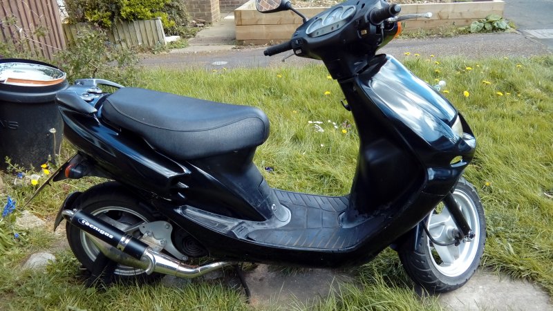

    This is pedro or to others its a Sym jet red devil / basi x / euro x ....... got this a year ago in a bad state of affairs , 6 owners and just run into the ground, last owner deceided to rattle can spray it in a satin/matt black without removing the panels. yeah they blasted it badly , coated the speedo, warning lights on dash, never etch primer'd the inner panels and also went straight over the decals. poor thing was in a state.
    fast forwards a year, its had a new pipe fitted, a larger 17.5mm carb and a 80 jet upsize , whole new rear pulley and clutch, new belt , new rollers, new uprated front headlight bulb (30% brighter than stock) , in all including diagnostic tests and labour -parts close to 1k
    over the past few days i have stripped of the panels, prepped them with a wet sand with 1500 grit wet n dry 3m paper and a wipe over with isopropol alcohol , they had 3 coats of halfords gloss black 2x 500ml rattle cans, and sprayed out side in the wind ( no booth or flashy gun here ). i do have some orange peel effects but nothing a second wet and dry wet sand wont flatten out and a quick dust over. but its looking 100x better than it did before ( front mudguard shows the before paint job as does the front forks )

    Your orange peel effect is because it went on too thick.
    It can be sanded out and over painted.
    Try using a high build primer

    aye never really thought about that i kept a good distance away from panels and tried not to thick it on , but you know spray cans lol one flow rate for all lol ........ the whole panel sides have took a beating what i thought was just sticker was sticker and road rash lol they need a real good sanding out or a real good thick HB primer/filler .
    good thing is from a distance it looks great lol but get to close you can see its got problems lol
