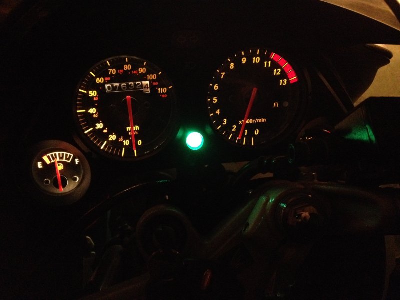

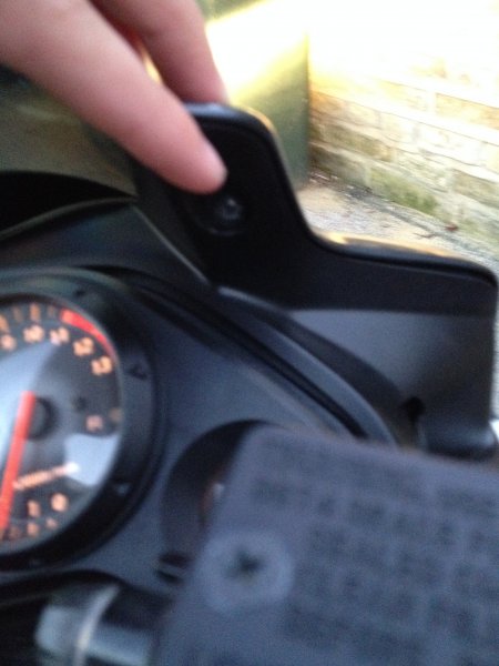

its in this picture the screw that keeps spinning (the one im pointing too ) just that i replaced a dash bulb on the left (inbetween the fuel gauge and speedo ) now them lights r bright and others are dim ffs
Would assume,if it's still spinning.that part of the thread has become rounded,instead of 'angled',which is why I suggested to attack from the other side..by pushing screw to part re-cut thread to get it to shift,then maybe a slightly larger screw/but only just - to r.cut thread.
The only other suggestion I could make,is to change the angle of it's screwing rotation - see if you can get a very thin bladed screwdriver,onto one side/to create pressure,as your unscewing it.mk.
