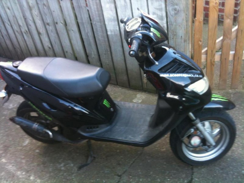

    Some of you might know I posted a while back about my ped, the problem being that it won't pull up hills :mad:.. it will happily do 45 mph on flat, but even on small hills it will not shift without a run up :mad:.
    had a new cylinder, piston and head in september last year (the problem came shortly after this),
    and had a new set of rollers in january.
    according to the garage that replaced the cylinder etc, the carb was set up properly :confused:
    SO, i'm currently thinking of ordering a set of clutch springs, a set of torque springs, and new rings.
    first. will i have to upjet for torque springs/clutch springs? (cannot find standard ones)
    how will i know if rings are buggered?
    i'm new to this but i am pretty sure i can replace these.
    it is standard apart from a tecnigas exhaust. (and yes i know they are terrible :D)
    cheers for any replies! :cool:
    bill.

    I think you need to get it set up right, it's made to work properly in std form, wrong weight rollers? Airfilter wrong? These scooters work so you have a problem. Fitting different parts are only masking the faults.

    fair. i don't have the money to get it on a dyno, but i'm going to check everything over when we get a decent spell of weather
