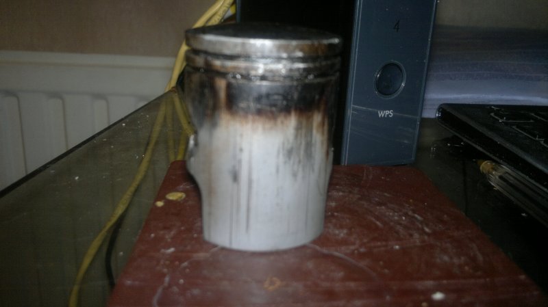

the piston ring could be broken, check it if it looks like this then your piston ring is broken, there should be no dirt below the top piston ring
Will look soon thanks mate it just died on me blew 2 fuses and there was watt on battery started and back fired is ok fit now haha

it wont be piston to just do it every now and again, it just needs set up, you got plenty compression. but if you really want to purchase some rings for 6 quid off ebay lol.
