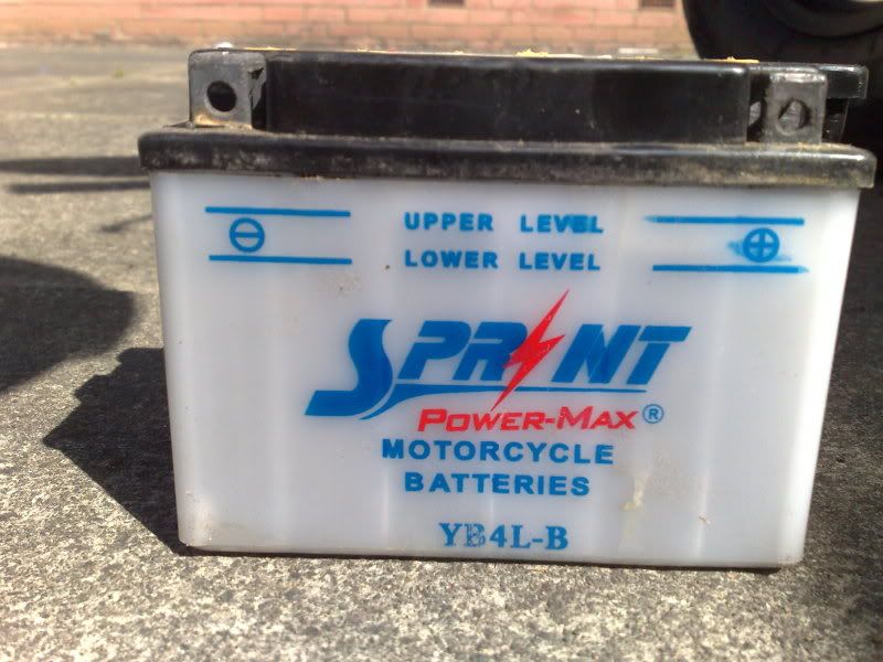

    this is the battery i have fitted [​IMG]
    im not sure if its the standard one or not :confused:cratch: so i need a better one than this any ideas ppl?
  6. MiNoR cOnFuSiOn
    ive started evo engines on these battery's.... putting holes in pistons is a sure sighn of too much compression/lean mixture.. this prittymuch explains your compression was too high andy..
    get a new battery, if it dont work the starter is shitty... if it still wont go you have not fitted the cylinder kit correctly
