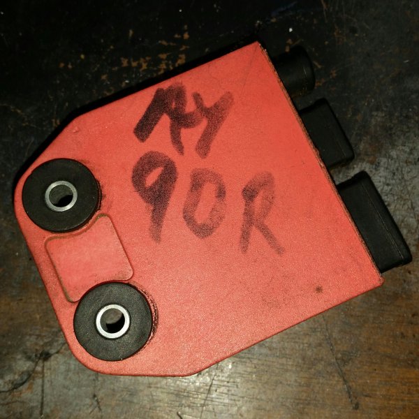

    So to the cdi- it should be the aec400 type but it has a red mitsuba unit fitted, by just one plug and a ground (I think) the immobiliser isn't connected at all. The cdi is specified for several Piaggios, 4 stroke 125's mostly.
    Could this cdi be the source of my occasional cutting out problem?
    I was thinking of buying a bypass unit and disconnecting the immobiliser entirely, as it doesn't seem to be doing anything anyway.

    Scootzmadness- I don't know a whole lot about cdi's or immobilisers but I would tend to agree with you that a previous owner has attempted a home made cdi bypass using something they found in their shed maybe. And how could it work if it's not designed for this ignition system?

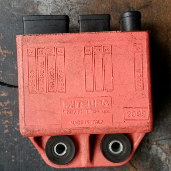

    It's not an aec400, it's a Mitsuba 2099.
    The plug from the loom to the other connection on the cdi won't fit either, i.e the keyways are incompatible.

    yeah its a piaggio model of the aec 400 buddy ;)

    Most engines are similar in the low end range with regards to mapping, Its only when it gets into higher range that it needs to really spark at different times (higher the rpm more sparking) the curve may be similar low end but could be out of whack top end and that COULD be why its bogging. My old Kymco would run off of a honda CDI well low end but wouldnt top end speed. It needs to be the right one for the right engine. There will be a slight difference between a CDI for a 125cc and a 100cc.. Its just best to have the right one for the right engine instead of having the wrong one in there.
    The immobiliser system is actually very simple in theory. One chip in the key, Read by a piece in the ignition itself which then sends a signal to the CDI/Immobiliser unit saying, yes right key - power up. Red key will send a different signal to black key so on, so on. If a key doesnt read properly by the ignition, the ignition wont tell the CDI, yep its good and it wont fire up.

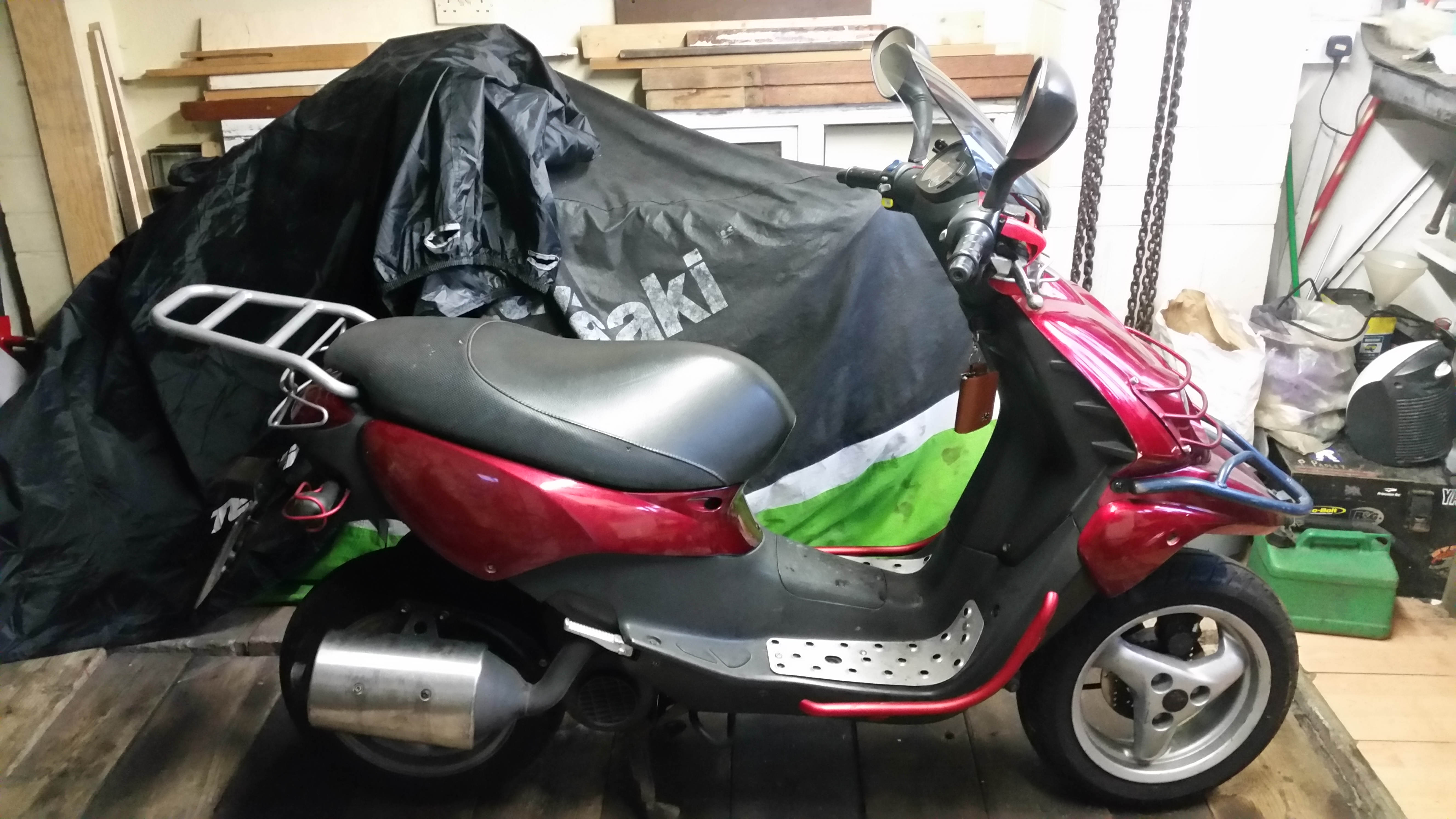

    The metalwork isn't standard for that model.
    I got all the red bits and pieces with a parts bundle from ebay. The front mudguard piece is off a 50cc Streetboard model (I think) and the rear rack was possibly an optional extra. Some have them, some don't, it seems.
    Some of them might come off, I'm not sure if I like it this way just yet.

    I found it on Google listed for a few Piaggio models but didn't investigate further.
    If anybody wants it they can have it FOC
