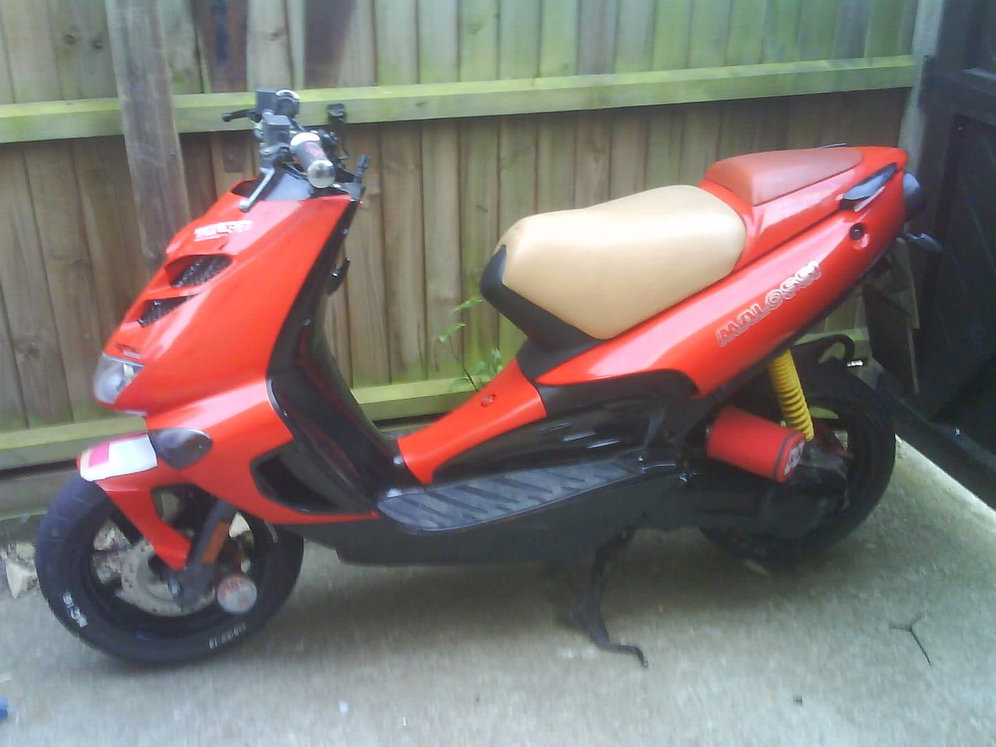

    yeh i used a trials biek stem i think, rake wa too much on it though, if the rake isnt as much as mine will be perfect and cheapest option ;)
    Pic whore :w00t: :
    :welcome:
  7. px166bajaj
    px166bajaj Active Member
    1,367
    Spanking colour, that.
  8. billy_sr
    billy_sr New Member
    822
    poppy red from focus :w00t: :w00t: :w00t: :w00t:
  9. Vesta
    Vesta New Member
    2,615
    I reaallllllyyyyyy Like that SR :drool:
