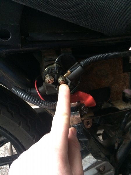

    Hi , over the past few weeks I've had a problem starting my bike , when hitting the electric start it just buzzes , then after a few goes the buzzing stops and I get nothing ... this last week I've been able to bump start it but yesterday I couldn't even do that , all lights, horn etc seem to be working fine , I charged the battery a few weeks ago as was getting the same problem and it worked intermittently, but eventually was back to square 1 ... any ideas? Also what is this part? The buzzing seems to come from here.

    thats your start relay, probably where the fault is. if you touch those 2 big cables together, the starter should turn over, if nothing happens, then the starter motor/cable is your problem
