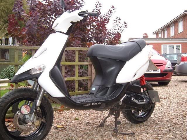

    Now I have got my used 13" NRG wheels from Ebay.
  6. Mehmet
    Mehmet Active Member
    2,976
    AUDI A3
    Yeah that looks MUCH better... nice one..
    Nice front disc also .... really big isnt it :p

    heres mine with the nrg rims.

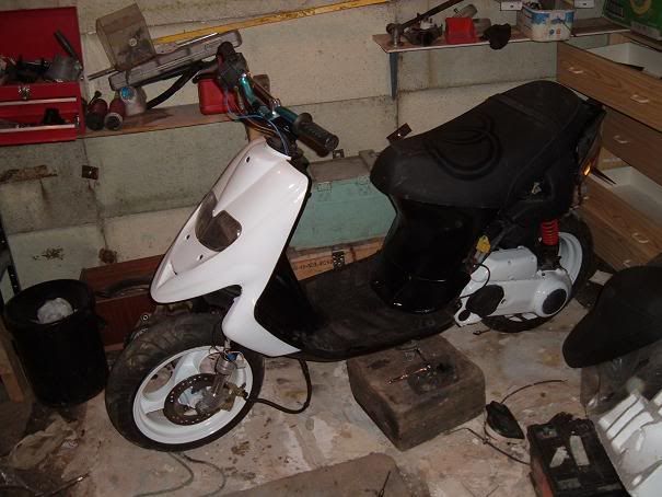

    ye, heres a couple more, they've all been posted on here before somewhere lol
    Through the different stages of its life
