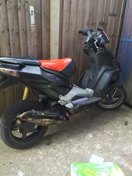

Sr50r dash and indicators dont work! Need some advice
Discussion in 'The Workshop' started by Oliver.44, Sep 15, 2016.
  1. Oliver.44
    Oliver.44 New Member
    5
    ive changed the fuses and had a quick look at the wiring and everything seems ok. the headlight will also only work when a little plug near the indicators is unclipped. any advice would be much appreciated.

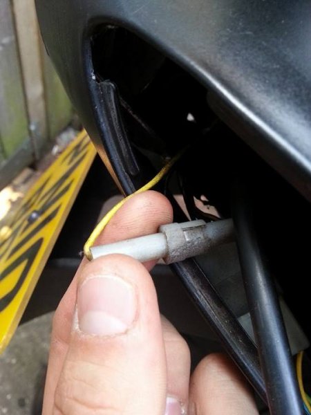

  4. Stevep
    Photos of this 'little plug' please?
    Sounds like a crossed wire somewhere.
    Any other bulbs blown or not working?
  5. Oliver.44
    5
    just the indicators and and the dash doesn't work atall.
  6. Stevep
    Thats a fuse holder for glass fuses:confused:.
    I can only conclude that you have a crossed wire(s) somewhere,considering that when you unplug it the headlight works.
    Looks like it's a body work off jobbie and start digging.
