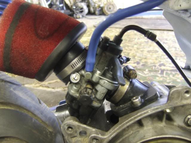

    ajust the bike hot. thats idle mix and speed.. let it cool don, using the choke to start the bike (adds more fuel obviously) if it doesent start wihth the choke you need to change the choe jet... if he idle mix screw is happy all te way in or more than 3 turns out it needs a different pilot jet. it depends where on the carb the screw is wether its biger or smller. gt a pic of the side of your carb, the idle speed and mix screw and ill tell you whatway is what

    heres, my carb, its just a runner 125 carb 20.5mm, ill have a play about with the mix's today, yesterday it would only start when the engine is completely dry of fuel then with the choke on, ill put a bit of petrol in the tank itll fire then the revs rise and itll not start again

    ok, the idle control is BEFOR the slide so it control's air.. so the more you wind it out the leaner the mix will get.. if you have to wind the screw more than 2 turns out it needs a smaller pilot jet.. vica versa
