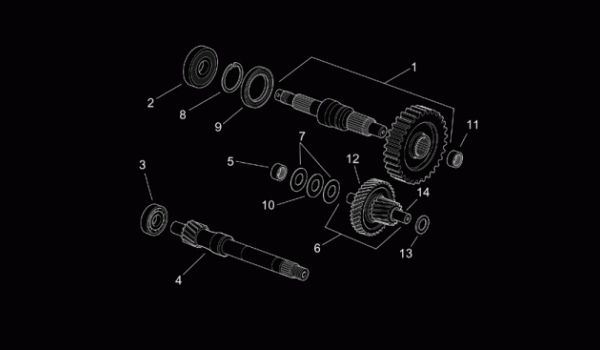

    Can anyone advise me on how to replace the rear bearings on the shaft , i have play through the wheel which is movement in the shaft so going to order the bearings
    2 8 9 11 are the correct bits to order arent they ?

    i ordered 2/8/9/11 in the end , waiting on delivery , any adivce on replacing ?

    Done Job today , was fairly easy just 5bokys behind the clutch bell and was simple , had an issue removing the small needle bearing from the case but was fairly easy .
    Play in the wheel all gone but still have an annoying rattle :( in the tranny case somewhere , I'm sure its now the rear brakes but that's for another post
