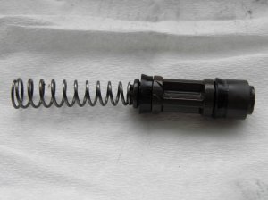

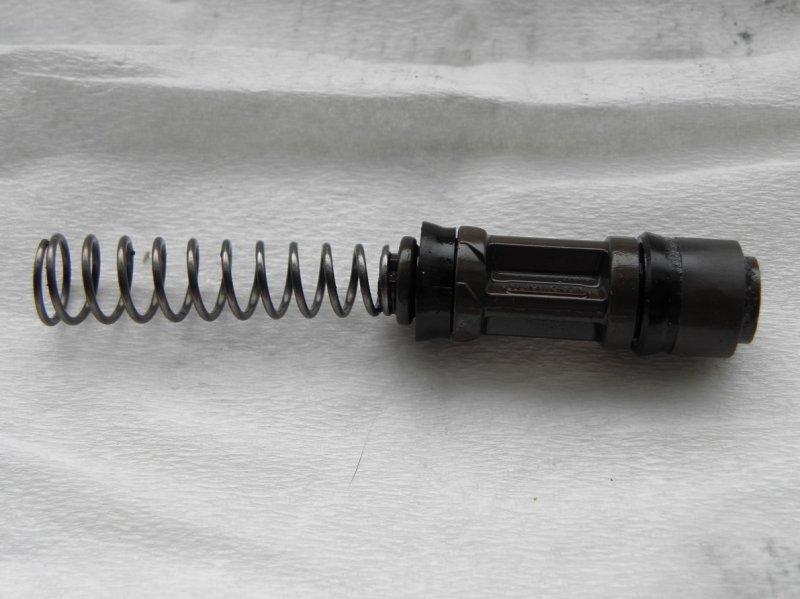

    Right I removed the master cylinder piston and it looks ok;

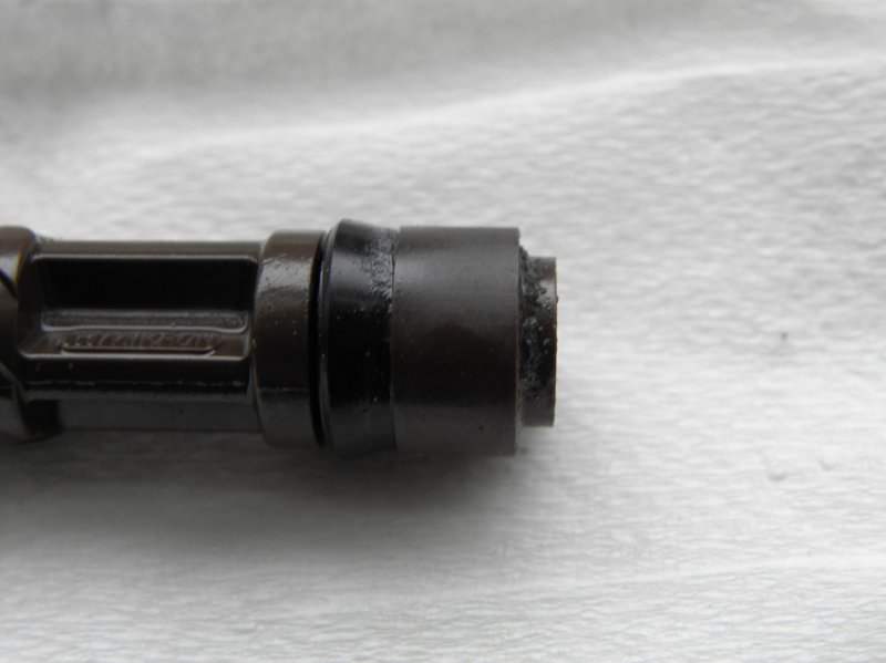

    The outer seal looks fine and in one area there is a little bit of gunk build up;

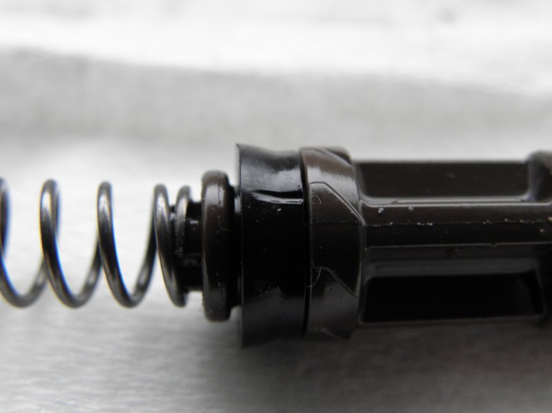

    The inner is fine, no rips or tears and is fine around the od - but on the id there is a smooth horizontal groove which doesn't reach the edge of the od;
    Could this have a part to play?
    Does anyone know any suppliers for Brembo brake spares?
    I've search and searched but can only seem to find calliper seals/rebuild kits but nothing for master cylinders for my model - ones that do individual components would be ideal.
