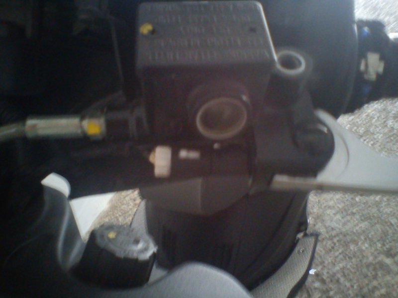

    Nrg electric gauges like mine suck balls! :mad: worst shit ever!!
    you might want to tell us exactly what doesnt work???
    for the brake lights remove your panel and check if this white thingy works correctly ;)
