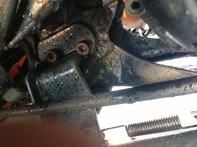

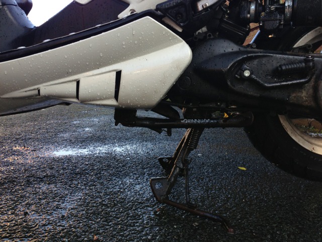

  7. TeZ258
    TeZ258 Member
    245
    Speedfight 50cc
    The side stand fits just in front of where the engine sub frame bolts to the frame on the left hand side(when looking at the back of the bike).
    Here's some pics of where it goes:
    It's pretty simple to install. Just 3 nuts and bolts.
