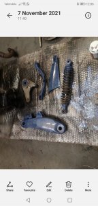

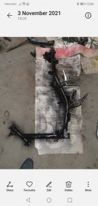

I have laid it out in some space in my garage and treated the frame for rust then hammerite.... I just used kurust to treat the frame

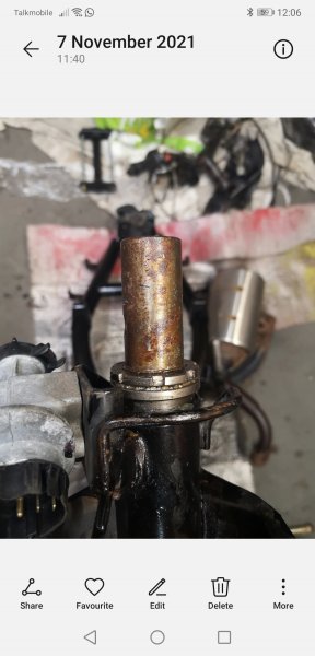

I've just fitted some header bearings but not happy with the fitment so will re look at them I think. Unless they look ok to everyone else. I also coated some bits by the front arm. I may spray the front swing arm black rather than the standard silver
ive used kurust myself on scoots and cars with good results... i have a bench vice in my shed, like all sheds in this country it gets quite damp in the winter months. i treated the rusty parts of the vice with kurust last summer, and when i checked the following summer there was no sign of the rust coming through again.
That's good especially as I'm over coating mine with hammerite anti rust paint should keep her protected

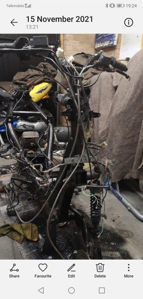

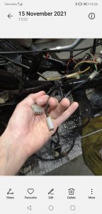

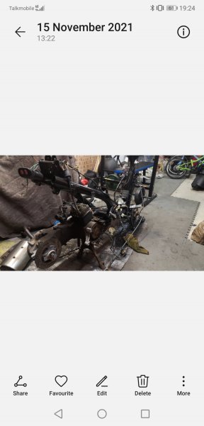

Figured I'd bolt some bits together to work out what I'm missing today. Also run the wiring loom to work out where it all plugs in

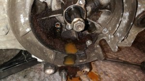

Got myself a new lock set, barrel key and CDI that plugs in to those 2 cables and fitted them all. Tipped the engine on Saturday to fit a new stand and water came out which is worrying as it's air-cooled so stripped the lump Sunday to bits and ordered new bearings, seals.
