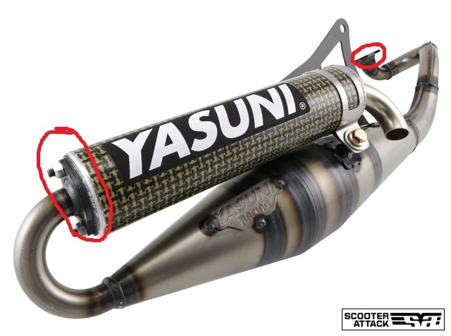

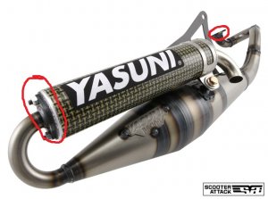

    if its running ok but loud i wouldn't bother getting a new exhaust. start the bike from cold and feel around the joins for air leaks. this will be from the pipe to the silencer or from the pipe to the engine (cylinder). if it has any leaks at these areas it will most probably need a new gasket.
    any other leak will be a hole in the actual exhaust, either get it welded or bin it and get a new un!
