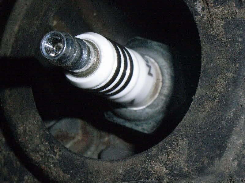

  10. capri dave
    capri dave Active Member
    5,076
    yeah well done, now take a picture of the part of the plug we need to see :confused:arc:

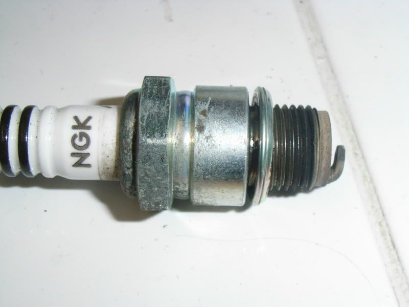

  11. Rick-UK
    Rick-UK New Member
    748
    Runner 200
    woops! Well the other end is just as clean as it was when new.
  12. kyle1b1
    :w00t: :w00t: :w00t: :w00t: :w00t: :w00t: :w00t: :w00t: :w00t: :w00t:
  13. MiNoR cOnFuSiOn
    can see its running hot, the electrode has burnt away from the centre (bent upwards)

  15. Rick-UK
    Rick-UK New Member
    748
    Runner 200
    Other end:
    Hot => lean => bigger jets?

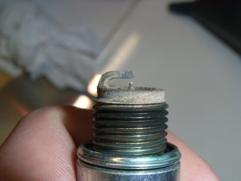

  16. kyle1b1
    not the other end!
    :msn1:
    the end that goes in the cylinder but a better one so can see further down the plug
  17. Rick-UK
    Rick-UK New Member
    748
    Runner 200
    Lmao, okay well I'm sort of new to this and have no idea what you ment before. I will get another photo soon :p

  19. capri dave
    5,076
    The electrode is an iridium, they are very thin on the end from new,
    it lowers the arc over voltage....
