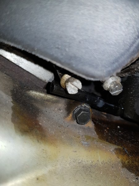

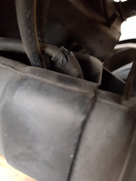

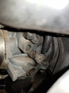

    Hi mate, had a quick look couldn't see much for concern, do I need to remove the airbox to see all the pipes? Or take the seat out?
    Snapped a few pictures don't know if they are just random pipes but you can see more than I can :(
    Thank you for the concern, I will not be riding it at all until this is fixed.

    metal float bowl, in the video its leaking bad from the inlet side of carb manifold to motor so much so its dripping off the jubile clip holding carb to manifold then running down to the carb bowl to. im hedging on its a fuel pipe leak.
    yes buddy im going to say you will need to remove that airbox to get a more better look at the carb as a whole. this way you can inspect the tubes and see if they are split. i am going to say you have a split fuel pipe and thats whats causing the massive leak
