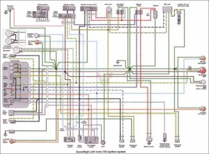

    Why they do not give you a picture of the wiring for a speed fight 100cc
  11. Tamiyacowboy
    Tamiyacowboy Pippa's Owner
    1,850
    Piaggio Skipper
    Speedfight schematics ( wire diagrams)
    without imobbilizer and with immobilizer
