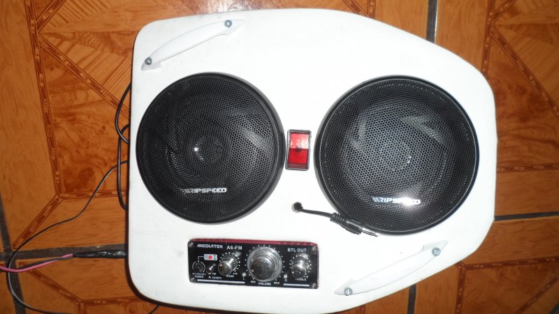

I made one with mdf covered in white vinyl two 4" ripspeed speakers from Halfrauds and an amp with fm radio and MP3 input from ebay. The whole unit cost less than £20, looks okay and sounds pretty good. I'll post a photo tommorow. Oh it doesn't draw too muche power and is a lot lighter than using a car cd.

I use my Iphone as the source, it connects to the black wired connecter (by right speaker on photo). I have fused two core wire running from the battery into the seat box which has a male/female double connector (from Maplins) this simply connects to the power lead with the other part of the connector, so it can be connected in a second. Mine has an illuminated switch as the amp does not have an on/off switch.
