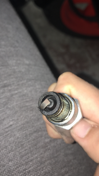

    Is the sparkplug okay? Or is it too rich/lean?
  2. scubabiker
    Little lean maybe? But im colourblind...
  3. Buzz
    Buzz Active Member
    446
    I'd say little rich. Look at the centre core area which should be a deep coffee colour. Yours is black. Ignore outer threads, they get oiled up. If the centre core is pale then it's lean, if very pale then stop riding. If your bike is running okay then leave it be, slightly rich is better than lean.
