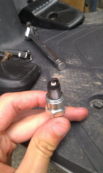

    took my spark plug out today just to have a look seen as ive done quite a bit of mileage in last couple of days n it came out like this would you say this is ok or is it running a bit rich/

    Looks a but rich mate or fuel and air mixture I wrong , it should have a brown tan or grey firing end , I can't really see in the pic

    Definitely looks a bit rich ! It shouldn't really have much carbon (Black) on it, and should be brownish.

    Lean!! Pure white is no good. Youll get carbon/blackness regardless of rich or lean on a 2 stroke because theyre so dirty lol always go by the condition/colour of the ceramic

    that spark plugs only been in the bike about a month

    hmmm mine was all black even the ceramic part..
