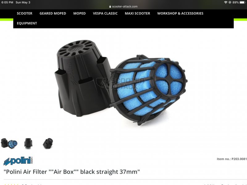

  7. scubabiker
    Yeah that could be it.
    What air filter you running?
  8. WWOOTT
    WWOOTT New Member
    8
    Polini straight air filter
    Item no.: P203.0081
    scubabiker likes this.
