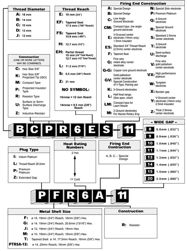

    there is a ngk r in my piaggio nrg 2005 ac atm but this guide says i need br9es instead of br9ecs which is in there now is this guide correct

    Just a variant of the BR9 plug afaik. Just means the tip is a different material for example iridium is BR9EX etc. Shouldnt be much different than the recommended one its the same heat range and the like.

    so can be replaced with br9es just the ecs has a different tip

    The C stands for low angle if you look below (Taken from NGK site)
