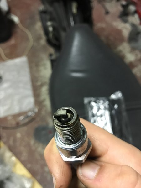

    Before i had 86 jet and i put 88 jet. Is the sparkplug too rich/lean or okay?
  2. asap
    asap Member
    49
    This is after 1or 2km
  3. Tamiyacowboy
    Tamiyacowboy Pippa's Owner
    1,850
    Piaggio Skipper
    looking better its hard to tell with plug so far away . but it does not look on the lean side
  4. asap
    asap Member
    49
    Thanks, i will try to take a better picture

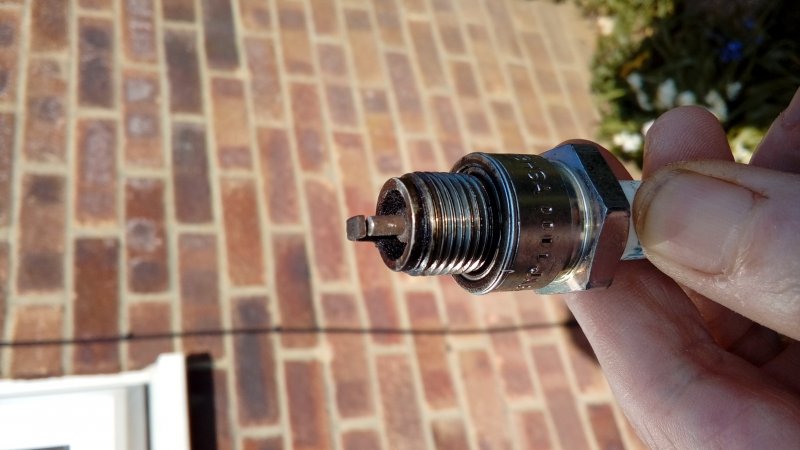

  5. Tamiyacowboy
    1,850
    Piaggio Skipper
    Here we go .....
    this is an image of my old spark plug i dragged out of the bin to show you what sort of colour your looking for. as you can see it has a chocolate brown staining or more like a tea brown staining , this is tell you the bike is jetted just right and its not running very lean or overly rich, its just right.
