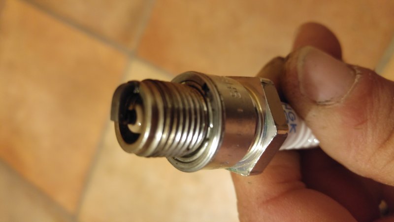

Hi Ive read many different posts and looked at lots of pictures of "how a plug should look like".... To be honest i thinks its fried my brain even more as everyone seems to have different views etc. I have a 1998 Neos 2 stroke. It has a standard airbox with red fiter foam (Mallossi if that sounds right), 17.5mm del and a techniqas pro silent exhaust. I was told a 68mj would be the correct one. Going on side of caution i started with a 74 and air/mixture screw 1.5 turns out. I gave it full throttle for about half a mile after warming up the engine for a few minutes then turned it off removed plug(i didnt come to a dead stop thou) I think its running lean...the white tip has turned a gray colour? Im having problems identifing the "correct colour" as i have read that gray is good(optimal) and also...yes you guessed....gray is bad(lean) I have lots of jets to test with but know which direction to go. Thanks in advance for any advice.

Cheers for reply mate. I have also read that the malossi red replacement foam doesnt actually do anything different than the standard anyway. Ive been speaking to somone this morning in the trade and he says im all but there. Im just on the lean side of being set up perfect...if that makes sense. He said try and raise the needle one notch...its currently set halfway. The standard mj in the original 12mm carb is 72 on the neos. You would assume that the bigger carb would need a smaller mj but it doesnt seem to be working that way. Back to the drawing board
