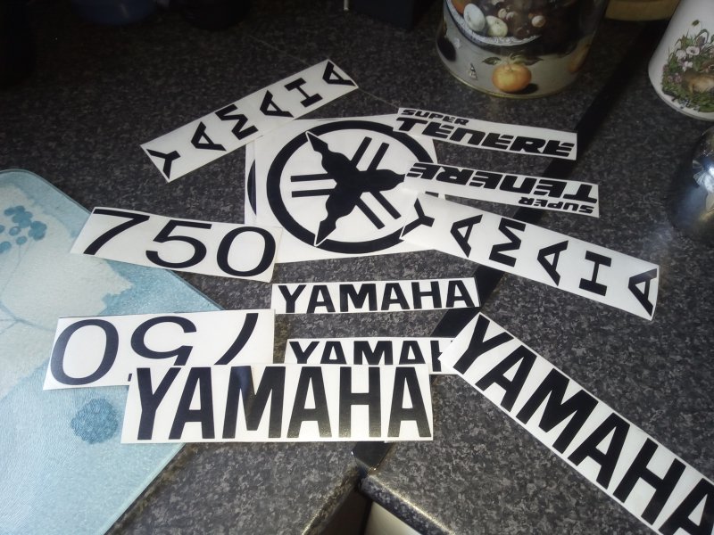

    woohoo, new decals!:D
  3. Stevep
    Get the weekend to work on my own stuff for a change. [​IMG]
    Neighbours done the decals:

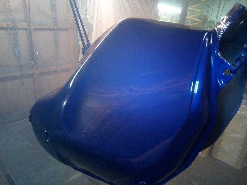

    Tanks now down to bare metal, best place to be as well. Surprisingly, I didn't find any nasty dents to deal with, bit of topping up to do around the rear fixing area, nothing that a bit of chemical metal won't cure.
    Still got to clean up the underside. I'm going to have the tank support sections off and fit some new captive bolts behind there, I seem to remember that 2 of the threads are stripped.
    Ok, now the underside is done as well. [​IMG] Doesn't appear to have any pin holes anywhere [​IMG] although there is obviously some pitting here and there. But good enough for a 26 year old metal bike tank.
    Wash down with some thinners and a tack rag and into primer me thinks....................
    tumtetumtetum
    1st coat
    Ooh, that kinda stands out a bit

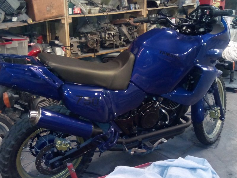

  10. Stevep
    Yikes, 4 months since an update on this.
    So, been stupid busy with the new transport operation and not had much time to play with the toys.
    I finally managed to get all the panels painted and on, except one which I had to re-paint (put the wrong activator in the paint and it all cracked)
    Fresh fuel in yesterday, got the old girl to fire up, first time in 12 months, and wouldn't you know it......the fuel pump is leaking like a sieve.
    Still have to do the chain and sprockets, adjust the tension and stuff, few other small things, check all the bolts to make sure they are tight and I haven't missed anything, then test the brakes and suspension. The new Renthal bars seem a lot narrower than the old set so I'll see how I get on with those, might order a wider set, we'll see.
    Thoughts are turning to the dash board, maybe a clocks upgrade, or maybe I'll just change the surround for something different.

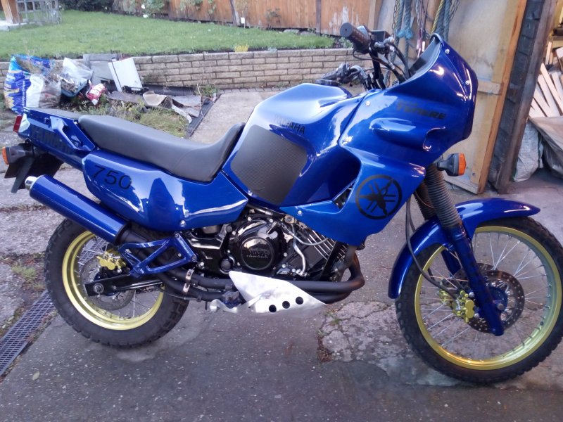

  13. Stevep
    So, it started life as this, a rather tatty, unloved thing, rough running, bad braking, petrol leaking, potential to go anywhere bike :
    Now, after putting it outside, it is still rather blue, but not so bad.
    Ordered a new screen and mirrors, should be here before the MOT next weekend.
    scubabiker likes this.
