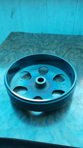

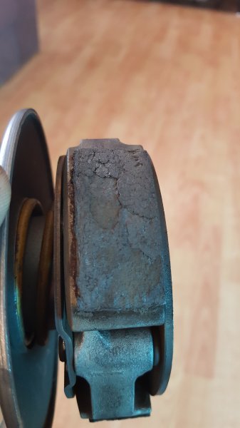

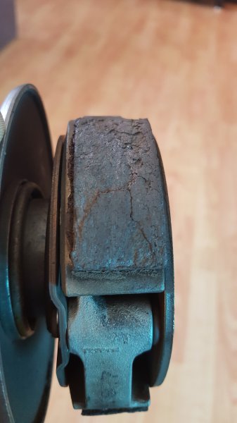

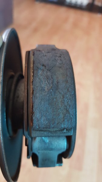

Hi guys so I got the clutch and this is what I've found the springs are ok and have tension I'm hoping that's the cause of the knocking so I've ordered a new 1
thats very strange looking, what did the clutch bell look like? looks like that got oil on it and just got too hot due to slipping.... or maybe it was stood for a very long time?
Holy crap on a cracker Never seen clutch slippers that bad. Replace the clutch springs as well. For the sake of £3 its a no brainer. But I'd still be surprised if that is the cause of the knocking, unless a clutch spring is broken of course.

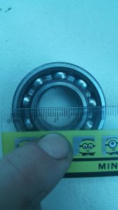

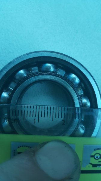

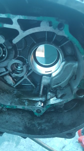

Checked the pins all seams fine I took the final drive shaft out and the bearings are knackered but there is no number so I can't match it I've looked on Google and I'm getting 2 different sizes can anyone help with the right size pls it's the bearing that goes in here I really appreciate your help
You need to measure the bearing outside diameter, inside diameter and thickness. I think it's a 6203 or 6204 bearing from when I rebuilt my TKR's engine, but please check. The original bearing is a metal shielded 'Z' type, I would recommend that you go for a '2RS' (rubber sealed) type as a replacement as they are more water and dirt-tight and will keep the gear oil in. I fitted 2RS bearings to my transmission. Only buy a decent brans such as SKF, NTN, FAG or similar and I recommend Simply Bearings as a decent web site to get them from. Edit: I Just checked my Simply Bearings account history. It was an FAG 6202 2RSR (15x35x11mm) bearing that I bought for mine (my bike is 50cc so check the output shaft diameter) and I also bought a 22x35x7mm Nitrile Rubber Rotary Shaft Oil Seal with Garter Spring R23 / TC to go with it. Total cost should be about £11 from Simply Bearings.
The 2 sizes I'm getting when searching are inner 20 outter 42 and inner 25 outter 47 mine is a 100cc 2005
