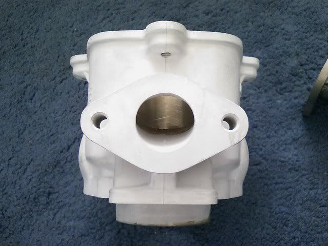

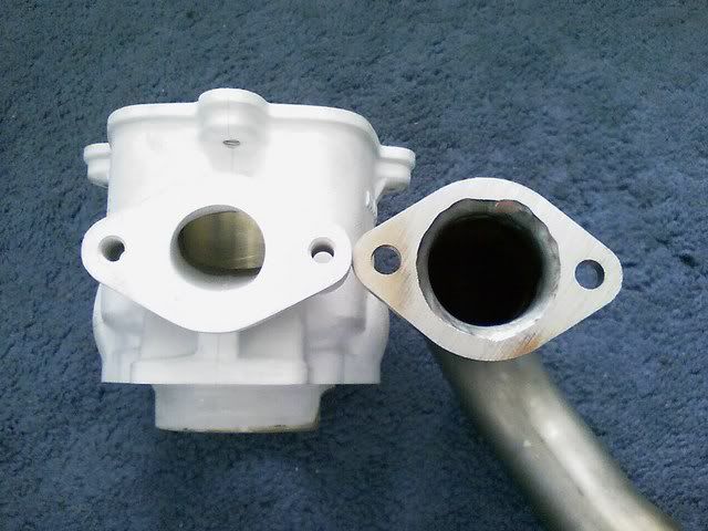

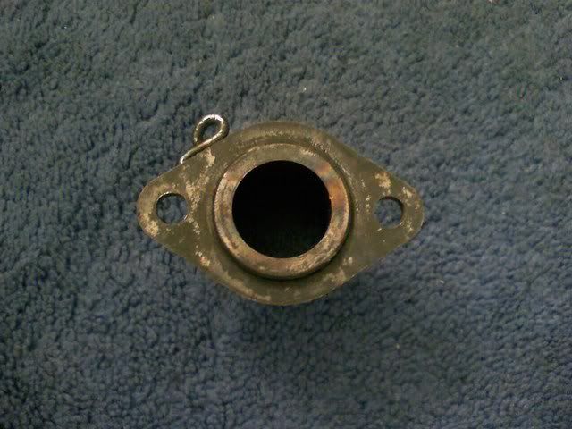

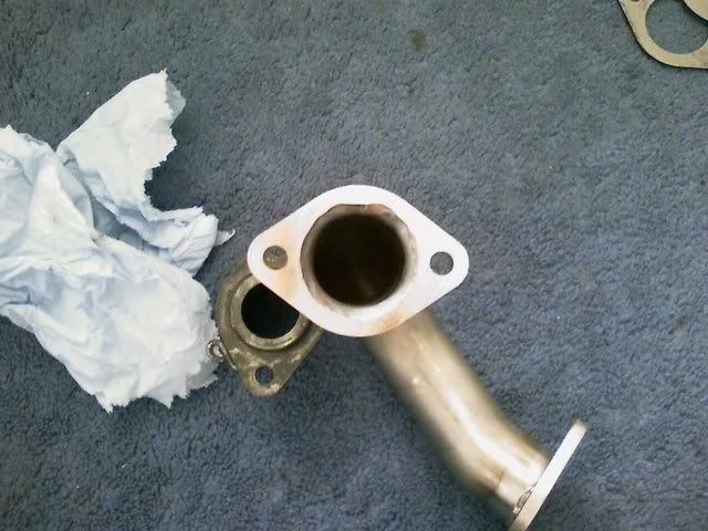

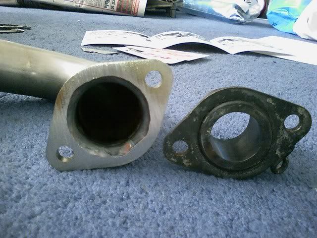

    so doing a lil comparison between the two today
    ~ Pm stub
    size of stub entrance
    ~ height - 2.65cm
    ~ width - 2.7cm
    ~Sip downpipe
    size of pipe entrance
    ~ height - 3.4cm
    ~ width - 3.3cm
    ~ malossi standard cylinder
    size of exit
    ~ height - 2.6cm
    ~ width - 2.7cm
    comparison picture of the two
    so PM have designed there stub based on a standard 172 as it is nearly an exact match.
    now sip have the right idea for the stock pipe, making the most of whats avaliable for easy power.
    going to have a nice long convo with graham about producing a SS stub,
    based on a larger exit people can match easily as i no afew mates who weld.
  2. Sw1fT
    Sw1fT Active Member
    2,940
    200SX S13
    woah that difference is amazing!
    nice find!
