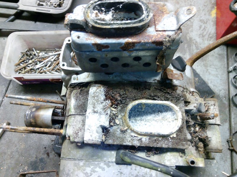

    The piston ring is supposed to be loose on the piston when it's out the bore, it's spring effect keeps it tight against the bore lining to create the compression. Just make sure that the ring opening lines up against the pin on re-assembly.
    The tell-tale sign of either a worn ring, sticky ring or a bore going oval is the black soot going past the ring and half way down the piston sides, as seen here:
    Have you done a compression test to verify you are losing compression via the piston and not somewhere else?
