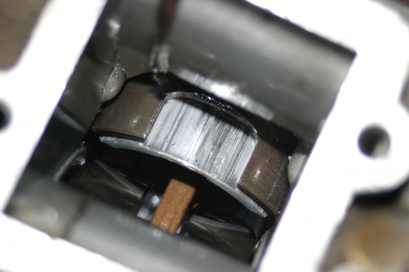

    Hi I have a Suzuki AY50 with a big bore kit..
    Once the kit was installed I took it out for a run...
    Every now and then it would stall after making a weird noise but start again no problem?
    Now, 3000 miles on I've decided to clean and spray all my engine and crank casing because it looks terrible.
    The bike was used all through the rough winter, without much love and got in a state. (crashed it twice :( )
    It was then put away for 6 months so its back out now.
    I took the inlet manifold off and saw the piston in this state..
    The performance on the bike was as good as it was when I first installed the kit?
    If anyone has any info it would be great :)
    Thanks in advance! :D
  2. roxy boy
    roxy boy Well-Known Member
    1,029
    roxi
    it is running lean and eubbing on the cylinder

  6. Mr Bizzle
    Mr Bizzle Active Member
    947
    04 Aerox 70 stage 6
    If it's boggy you might have overjetted it. The scoring is from when you were running lean and it suffered heat seizure (weird noise and stalling) if its running then don't worry about it, just check your jetting.
