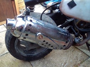

That's a shame, as it's a more than half decent silencer.....the one that's on at the moment is not too bad, it just has a small split in the pipe....I may be able to wrap it, failing that a new one I think......
You should have a quick read about 2t pipes. Vastly different from 4t ones. Four stroke pipes pretty much just silence and filter out gasses. 2t ones do a whole lot more, it's fascinating actually, the way pulses from the pipe create a sort of vacuum.... I've wondered for a long time how an expansion chamber would work on a 4 stroke...
Looks like a new exhaust system is in order.....just discovered that the front pipe, just down from the manifold, has a crack in it........better start saving........

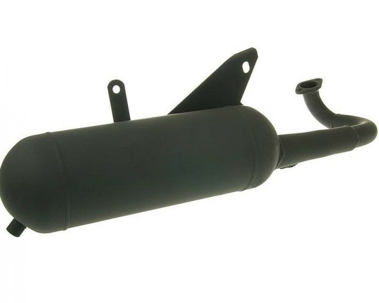

So the new exhaust is on order.....coming from Germany, and will be a couple of weeks, so this may be a little premature......when fitting it, is it good practice to use a sealant ?.....some sort of high temp. stuff at the manifold ?.....any thoughts welcomed.....
Copper grease to hold the gasket in place and on the bolts. Thank me in a year when you take it off again
It's grease, but copper based. Well worth buying. You can use it on battery terminals and all sorts. Essentially it's to stop bolts rusting tight. But you can use it on electrical connectors too. I buy a big tub each year, use it on my car wheel nuts too...
